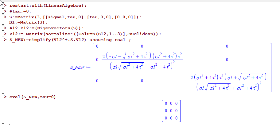

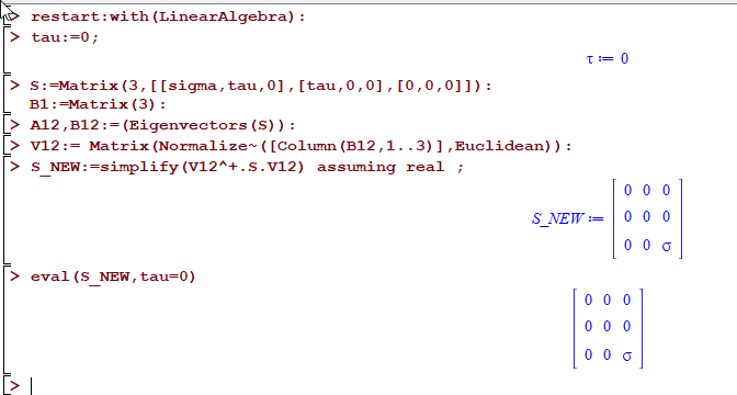

i have a matrix named S. it has two variables with the names sigma1 and tau. i do some computations with these varibels to obtain a matrix named S_NEW. when i calculate S_NEW with parameters and then i substitute parameter tau with zero i got the answer a zero Matrix. but when i put tau=0 at the initiation of my code, i got another answer. what is the problem?
the second issue is related with the name of parametes in maple. when the varible has the name sigma1 (and tau=0), the matrix S_NEW is a matrix with the only component of (1,1). when i change the parameter name to sigma the matrix S_NEW is a matrix with the only component of (3,3). where is the problem?
restart:with(LinearAlgebra):
tau:=0;
S:=Matrix(3,[[sigma1,tau,0],[tau,0,0],[0,0,0]]):B1:=Matrix(3):
A12,B12:=(Eigenvectors(S)):
V12:= Matrix(Normalize~([Column(B12,1..3)],Euclidean)):
S_NEW:=simplify(V12^+.S.V12) assuming real ;
Matrix(3, 3, {(1, 1) = sigma1, (1, 2) = 0, (1, 3) = 0, (2, 1) = 0, (2, 2) = 0, (2, 3) = 0, (3, 1) = 0, (3, 2) = 0, (3, 3) = 0})
eval(S_NEW,tau=0)
