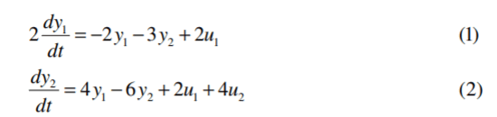

Hello
I have this problem:
in which I have to find the four transfer functions relating the outputs(yand y2) to the inputs (u1,u2).
The u and y are deviation variables.
The objective is to find the four transfer functions:
So I have done it by hand but I was wondering if there are any maple commands, that could be used to solve such a question?
I found the transfer functions to be:
