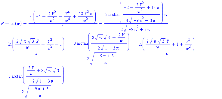

P:=subs(y(w)=Y,eval(lhs(Ans[1, 1]), [_C1 = 0, m = 1]))
ln(w)+(1/4)*ln(-1-2*Y^2/w^2-Y^4/w^4+12*Y^2*Pi/w^2)-(3/2)*arctan((1/4)*(-2-2*Y^2/w^2+12*Pi)/(-9*Pi^2+3*Pi)^(1/2))*Pi/(-9*Pi^2+3*Pi)^(1/2)+(1/4)*ln(2*Pi^(1/2)*3^(1/2)*Y/w-Y^2/w^2-1)-(3/2)*arctan((1/2)*(2*Pi^(1/2)*3^(1/2)-2*Y/w)/(1-3*Pi)^(1/2))/((-9*Pi+3)/Pi)^(1/2)-(1/4)*ln(2*Pi^(1/2)*3^(1/2)*Y/w+1+Y^2/w^2)+(3/2)*arctan((1/2)*(2*Y/w+2*Pi^(1/2)*3^(1/2))/(1-3*Pi)^(1/2))/((-9*Pi+3)/Pi)^(1/2)

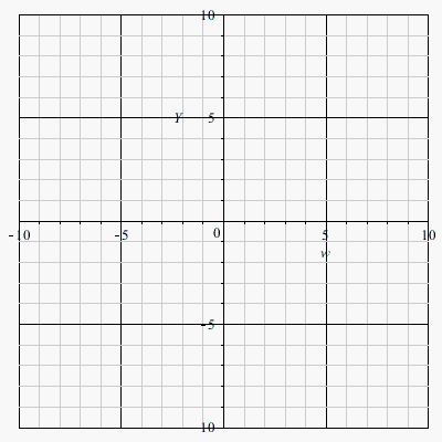

implicitplot(P,w=-10..0,Y=0..10)
evalf((eval(P,[w=1,Y=1])))
1.655474573+.8307038310*I
