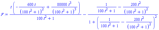

# Source term
F := t*(-600*t/(100*t^2+1)^2+80000*t^3/(100*t^2+1)^3)/(100*t^2+1)-(1/(100*t^2+1)-200*t^2/(100*t^2+1)^2)/(1+(1/(100*t^2+1)-200*t^2/(100*t^2+1)^2)^2);

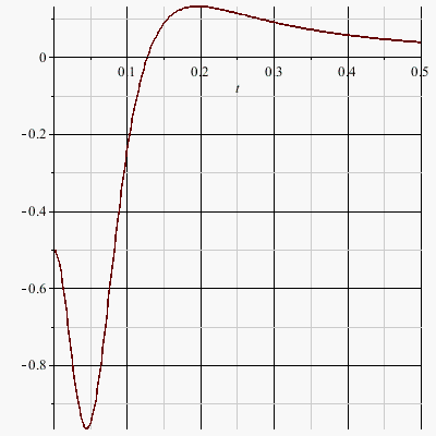

plot(F, t=0..0.5);
