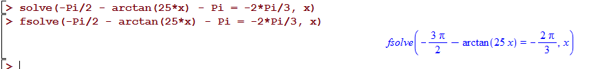

Using Maple 2020 I can't seem to get a trigonometric equation (fairly simple at that) to solve properly.
solve_err.mw
Here's a capture :
Expected answer is 1/(25*sqrt(3))
Adding +2*Pi on the RHS to match the sign doesn't work either.
