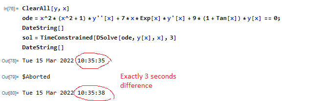

Compare the above example to Mathematica where it times out at almost exactly to the requested timeout. Here I ask for 3 seconds timeout
I am not asking for exact timeout. But asking for 1 minute timeout and getting 8 minutes is not good at all.
1.5 minutes is OK. even 2 minutes is OK.
