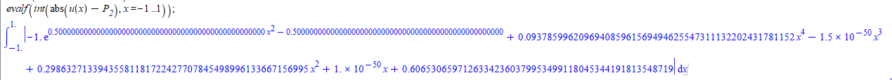

Hello everyone, I'm trying to interpolate a function using the roots of a Chebyshev polynomial as interpolation points, and then compute the absolute error. I want to compute that error via numerical integration, however, Maple is returning the expression of the integration itself. Why is that?
This is the code I'm using:
with(CurveFitting):
u := x -> exp(1/2*x^2 - 1/2):
r := evalf(allvalues(RootOf(ChebyshevT(5, x), x))):
points := Vector(5, i -> r[i]):
u_points := Vector(5, i -> u(points[i])):
P__2 := PolynomialInterpolation(points, u_points, x):
evalf(int(abs(u(x) - P__2), x = -1 .. 1))
This is the result:
