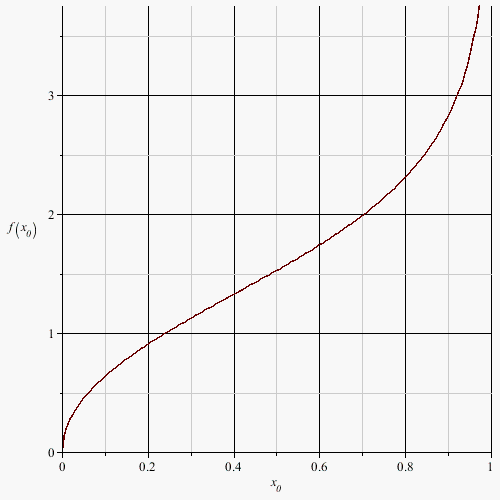

Example with incomplete elliptic integral of the first kind
(1) |
![Range := 0 .. 1; plot(f(x__0), x__0 = Range, labels = [x__0, 'f(x__0)'])](/view.aspx?sf=235964_question/3a31c5cac2470456e6df9f5eee1ac271.gif)
Defining the inverse of
