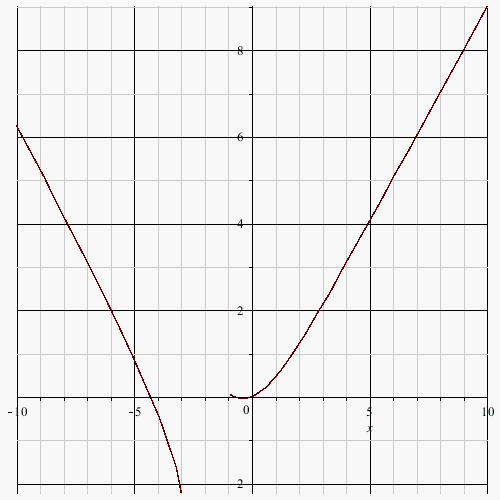

ode:=diff(y(x), x) = (3*x - y(x) + 1)/(3*y(x) - x + 5);
ic:=y(0)=0;
dsolve({ode,ic});
plot(rhs(%),x=-10..10,numpoints=10);
evalf(subs(x=3,%%));
evalf(subs(x=-3,%%%));

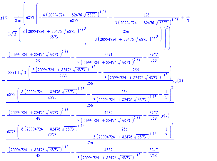

Since allvalues fails on this expression for real valued x, rational and integer values are tried for punctual comaprision
subs(x=3,sol);
allvalues(%);
evalf(%)
y(3) = RootOf(-6*((6+_Z)/(2+3*_Z))^(2/3)*(-4*(-2+_Z)/(2+3*_Z))^(1/3)*_Z-4*((6+_Z)/(2+3*_Z))^(2/3)*(-4*(-2+_Z)/(2+3*_Z))^(1/3)+2*(-4)^(1/3)*3^(2/3))
y(3) = (6873/256)*(-(4/6873)*(20994724+82476*6873^(1/2))^(1/3)-(128/3)/(20994724+82476*6873^(1/2))^(1/3)+1/3-((1/2)*I)*3^(1/2)*((8/6873)*(20994724+82476*6873^(1/2))^(1/3)-(256/3)/(20994724+82476*6873^(1/2))^(1/3)))^2+(1/96)*(20994724+82476*6873^(1/2))^(1/3)+(2291/3)/(20994724+82476*6873^(1/2))^(1/3)-8947/768+((2291/256)*I)*3^(1/2)*((8/6873)*(20994724+82476*6873^(1/2))^(1/3)-(256/3)/(20994724+82476*6873^(1/2))^(1/3)), y(3) = (6873/256)*((8/6873)*(20994724+82476*6873^(1/2))^(1/3)+(256/3)/(20994724+82476*6873^(1/2))^(1/3)+1/3)^2-(1/48)*(20994724+82476*6873^(1/2))^(1/3)-(4582/3)/(20994724+82476*6873^(1/2))^(1/3)-8947/768, y(3) = (6873/256)*((8/6873)*(20994724+82476*6873^(1/2))^(1/3)+(256/3)/(20994724+82476*6873^(1/2))^(1/3)+1/3)^2-(1/48)*(20994724+82476*6873^(1/2))^(1/3)-(4582/3)/(20994724+82476*6873^(1/2))^(1/3)-8947/768
y(3) = -6.067982077+1.049560864*I, y(3) = 2.13596417, y(3) = 2.13596417

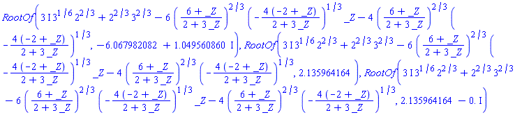

Two roots match the dsolve solution without method. However doing the same only on the right hand side produces different output. For some reason allvalues produces 3 RootOf expressions with a numerical root selector.
subs(x=3,rhs(sol));
allvalues(%);
evalf(%)
RootOf((3*I)*3^(1/6)*2^(2/3)+2^(2/3)*3^(2/3)-6*((6+_Z)/(2+3*_Z))^(2/3)*(-4*(-2+_Z)/(2+3*_Z))^(1/3)*_Z-4*((6+_Z)/(2+3*_Z))^(2/3)*(-4*(-2+_Z)/(2+3*_Z))^(1/3), -6.067982082+1.049560860*I), RootOf((3*I)*3^(1/6)*2^(2/3)+2^(2/3)*3^(2/3)-6*((6+_Z)/(2+3*_Z))^(2/3)*(-4*(-2+_Z)/(2+3*_Z))^(1/3)*_Z-4*((6+_Z)/(2+3*_Z))^(2/3)*(-4*(-2+_Z)/(2+3*_Z))^(1/3), 2.135964164), RootOf((3*I)*3^(1/6)*2^(2/3)+2^(2/3)*3^(2/3)-6*((6+_Z)/(2+3*_Z))^(2/3)*(-4*(-2+_Z)/(2+3*_Z))^(1/3)*_Z-4*((6+_Z)/(2+3*_Z))^(2/3)*(-4*(-2+_Z)/(2+3*_Z))^(1/3), 2.135964164-0.*I)
-6.067982082+1.049560860*I, 2.135964164, -6.067982082+1.049560860*I
Why this change?
