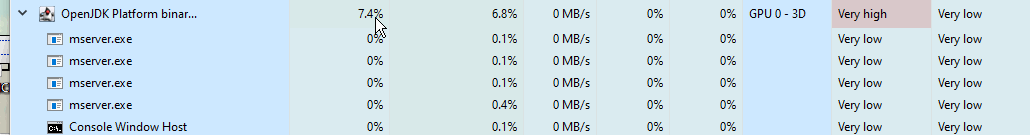

Killing every mserver.exe does not even resolve this. I had to terminate all of Maple from the task manager. The strange thing, is that looking at task manager I see mserver.exe doing nothing. zero CPU. Only the front end process is at high CPU (the one with the Java icon).  It looks like the Java frontend is locked up for some reason.
