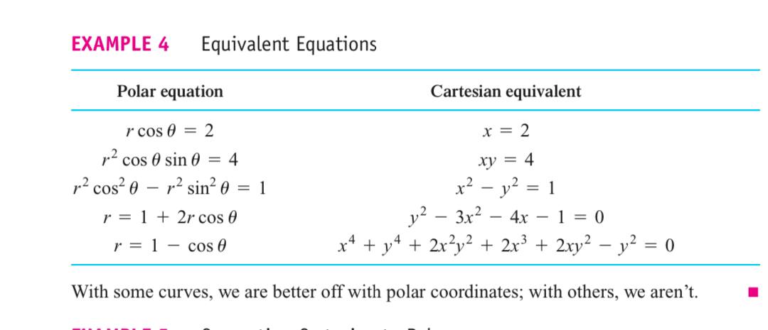

Question: How change cartesian to polar step by step?
I did some example to change them but i didn't get the same result as book did it and i try to figure out by hand i get another result i know all of them are true but polar is for making the simple shap for ploting so How i can get the simple shape and if possible How do step by step like using totur we have for polar or not?
with(PDEtools)
with(LinearAlgebra)
with(SolveTools)
with(plots); with(plottools)
with(VectorCalculus)
with(Student:-LinearAlgebra)
with(Student:-MultivariateCalculus)
S := x^2+y^2-1
x^2+y^2-1
convert(S, polar)
polar(abs(x^2+y^2-1), argument(x^2+y^2-1))
ChangeOfVariables(S, [cartesian[x, y], polar[r, theta]])
r^2*cos(theta)^2+r^2*sin(theta)^2-1
solve(%, r)
1, -1
T := x^4+2*x^2*y^2+y^4+2*x^3+2*x*y^2-y^2
ChangeOfVariables(T, [cartesian[x, y], polar[r, theta]])
r^4*cos(theta)^4+2*r^4*cos(theta)^2*sin(theta)^2+r^4*sin(theta)^4+2*r^3*cos(theta)^3+2*r^3*cos(theta)*sin(theta)^2-r^2*sin(theta)^2
simplify(%)
r^2*(-sin(theta)^2+r*(r+2*cos(theta)))
solve(%, r)
0, 0, -cos(theta)+(cos(theta)^2+sin(theta)^2)^(1/2), -cos(theta)-(cos(theta)^2+sin(theta)^2)^(1/2)
R := -3*x^2+y^2-4*x-1
-3*x^2+y^2-4*x-1
ChangeOfVariables(R, [cartesian[x, y], polar[r, theta]])
-3*r^2*cos(theta)^2+r^2*sin(theta)^2-4*r*cos(theta)-1
simplify(%)
-4*r^2*cos(theta)^2-4*r*cos(theta)+r^2-1
solve(%, r)
-1/(2*cos(theta)+1), -1/(2*cos(theta)-1)
