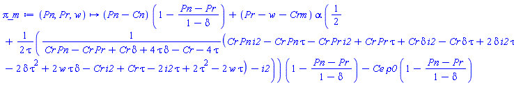

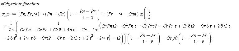

I am attempting to solve an optimization problem using the Karush–Kuhn–Tucker (KKT) conditions, where the objective function is to be maximized subject to a constraint that may or may not be binding. However, when solving the system, the KKT multiplier (μ1​) consistently evaluates to zero, even when the constraint appears to be active. I am unable to determine the optimal value of μ1​ and seek guidance on how to obtain the optimal values of Pn, Pr, and w, as well as the correct condition for μ1​.
with(Optimization); with(plots); with(LinearAlgebra)
_local(Pi)
Pi
`π_m` := proc (Pn, Pr, w) options operator, arrow; (Pn-Cn)*(1-(Pn-Pr)/(1-delta))+(Pr-w-Crm)*alpha*(1/2+(1/2)*((Cr*Pn*i2-Cr*Pn*tau-Cr*Pr*i2+Cr*Pr*tau+Cr*delta*i2-Cr*delta*tau+2*delta*i2*tau-2*delta*tau^2+2*w*tau*delta-Cr*i2+Cr*tau-2*i2*tau+2*tau^2-2*w*tau)/(Cr*Pn-Cr*Pr+Cr*delta+4*tau*delta-Cr-4*tau)-i2)/tau)*(1-(Pn-Pr)/(1-delta))-Ce*rho0*(1-(Pn-Pr)/(1-delta)) end proc

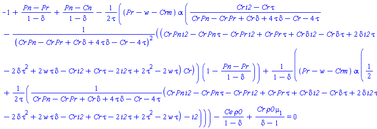

-1+(Pn-Pr)/(1-delta)+(Pn-Cn)/(1-delta)-(1/2)*(Pr-w-Crm)*alpha*((Cr*i2-Cr*tau)/(Cr*Pn-Cr*Pr+Cr*delta+4*delta*tau-Cr-4*tau)-(Cr*Pn*i2-Cr*Pn*tau-Cr*Pr*i2+Cr*Pr*tau+Cr*delta*i2-Cr*delta*tau+2*delta*i2*tau-2*delta*tau^2+2*delta*tau*w-Cr*i2+Cr*tau-2*i2*tau+2*tau^2-2*tau*w)*Cr/(Cr*Pn-Cr*Pr+Cr*delta+4*delta*tau-Cr-4*tau)^2)*(1-(Pn-Pr)/(1-delta))/tau+(Pr-w-Crm)*alpha*(1/2+(1/2)*((Cr*Pn*i2-Cr*Pn*tau-Cr*Pr*i2+Cr*Pr*tau+Cr*delta*i2-Cr*delta*tau+2*delta*i2*tau-2*delta*tau^2+2*delta*tau*w-Cr*i2+Cr*tau-2*i2*tau+2*tau^2-2*tau*w)/(Cr*Pn-Cr*Pr+Cr*delta+4*delta*tau-Cr-4*tau)-i2)/tau)/(1-delta)-Ce*rho0/(1-delta)+Cr*rho0*mu[1]/(delta-1) = 0

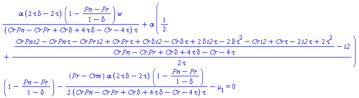

alpha*(1/2+(1/2)*((Cr*Pn*i2-Cr*Pn*tau-Cr*Pr*i2+Cr*Pr*tau+Cr*delta*i2-Cr*delta*tau+2*delta*i2*tau-2*delta*tau^2+2*delta*tau*w-Cr*i2+Cr*tau-2*i2*tau+2*tau^2-2*tau*w)/(Cr*Pn-Cr*Pr+Cr*delta+4*delta*tau-Cr-4*tau)-i2)/tau)*(1-(Pn-Pr)/(1-delta))-(1/2)*(Pr-w-Crm)*alpha*(2*delta*tau-2*tau)*(1-(Pn-Pr)/(1-delta))/((Cr*Pn-Cr*Pr+Cr*delta+4*delta*tau-Cr-4*tau)*tau)-mu[1] = 0
alpha*(2*delta*tau-2*tau)*(1-(Pn-Pr)/(1-delta))*w/((Cr*Pn-Cr*Pr+Cr*delta+4*delta*tau-Cr-4*tau)*tau)+alpha*(1/2+(1/2)*((Cr*Pn*i2-Cr*Pn*tau-Cr*Pr*i2+Cr*Pr*tau+Cr*delta*i2-Cr*delta*tau+2*delta*i2*tau-2*delta*tau^2-Cr*i2+Cr*tau-2*i2*tau+2*tau^2)/(Cr*Pn-Cr*Pr+Cr*delta+4*delta*tau-Cr-4*tau)-i2)/tau)*(1-(Pn-Pr)/(1-delta))-(1/2)*(Pr-Crm)*alpha*(2*delta*tau-2*tau)*(1-(Pn-Pr)/(1-delta))/((Cr*Pn-Cr*Pr+Cr*delta+4*delta*tau-Cr-4*tau)*tau)-mu[1] = 0
