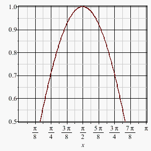

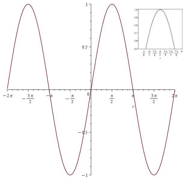

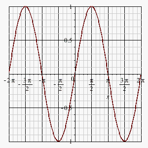

How do I generate a plot within a plot as shown in my example below? The fundemental issue is plot structures like Histogram() etc are not images and so combining them in the way I imagine is non-trivial. I couldn't find a standard way to do this in the help section.
Plot_within_a_plot.mw
NULL``
with(plots)
Consider the two plots p1 and p2.
p1 := plot(sin(x), size = [300, 300])
p2 := plot(sin(x), view = [0 .. Pi, .5 .. 1], size = [300, 300], axes = boxed)
How do I generate a plot within a plot as shown below, if I calculated the plots ahead of time? Is there a standard way to do this?
Download Plot_within_a_plot.mw
