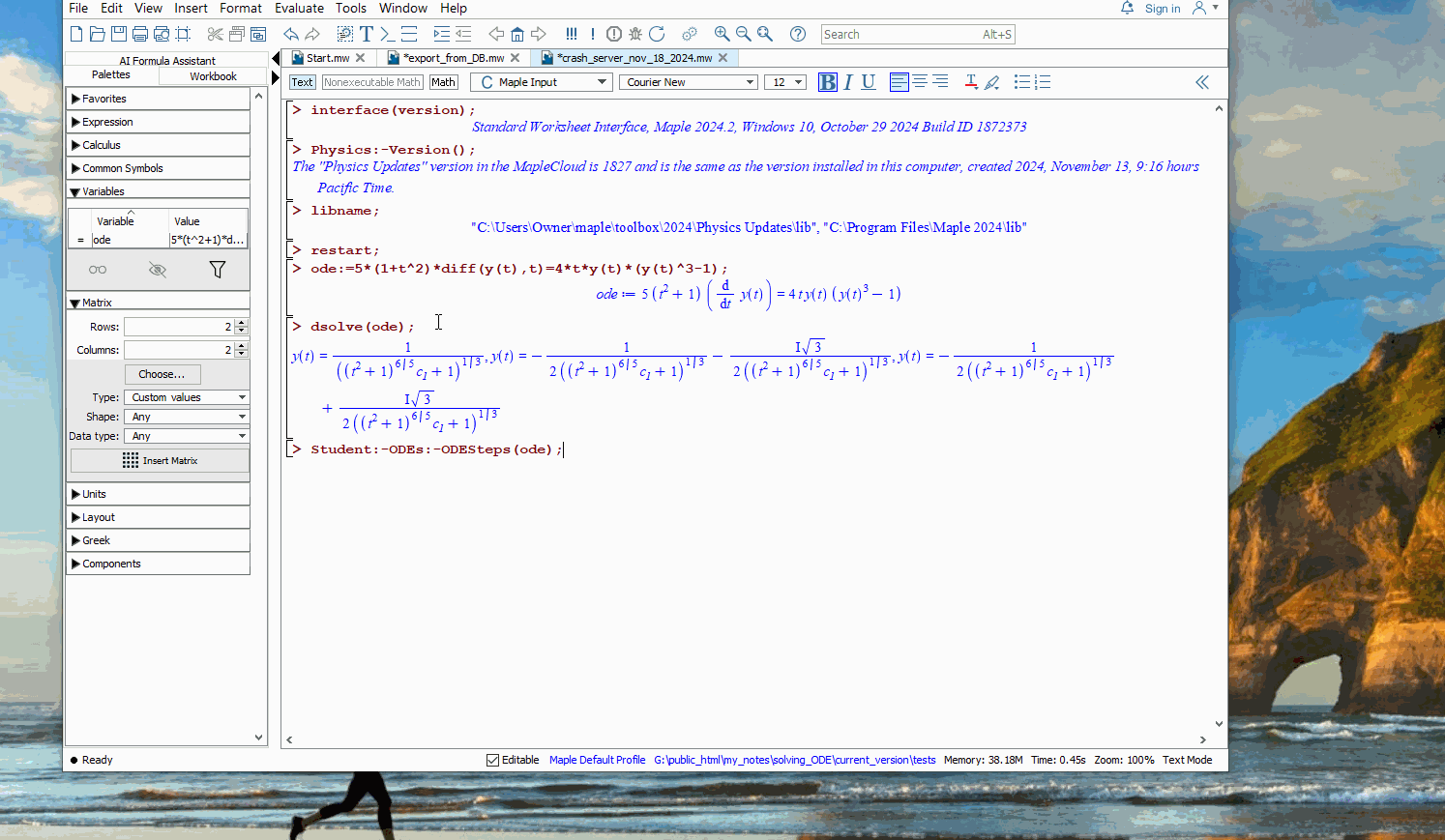

I was not expecting odesteps to show steps for this ode, but crash the server each and everytime?
Anyone could find why? I am using Maple 2024.2 on windows 10 with latest Physics. This might indicate serious problem somewhere. Software should not really crash this easily.
`Standard Worksheet Interface, Maple 2024.2, Windows 10, October 29 2024 Build ID 1872373`
Physics:-Version();
`The "Physics Updates" version in the MapleCloud is 1827 and is the same as the version installed in this computer, created 2024, November 13, 9:16 hours Pacific Time.`
libname;
"C:\Users\Owner\maple\toolbox\2024\Physics Updates\lib", "C:\Program Files\Maple 2024\lib"
ode:=5*(1+t^2)*diff(y(t),t)=4*t*y(t)*(y(t)^3-1);
5*(t^2+1)*(diff(y(t), t)) = 4*t*y(t)*(y(t)^3-1)
dsolve(ode);
y(t) = 1/((t^2+1)^(6/5)*c__1+1)^(1/3), y(t) = -(1/2)/((t^2+1)^(6/5)*c__1+1)^(1/3)-((1/2)*I)*3^(1/2)/((t^2+1)^(6/5)*c__1+1)^(1/3), y(t) = -(1/2)/((t^2+1)^(6/5)*c__1+1)^(1/3)+((1/2)*I)*3^(1/2)/((t^2+1)^(6/5)*c__1+1)^(1/3)
Student:-ODEs:-ODESteps(ode);
Download crash_server_nov_18_2024.mw
here is small movie
