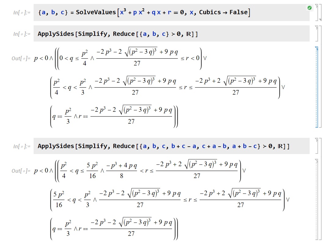

Mathematica can handle an equivalent query:
In[21]:= Assuming[{x*z == 0}, Refine[x*y*z == 0]]
