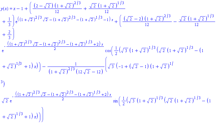

As I said, this is a recreational experiment ;-) .DGL_test.mw
ode := x^2 = sum(x*(diff(y(x), [`$`(x, i)]))/factorial(i), i = 0 .. 3)
x^2 = x*y(x)+x*(diff(y(x), x))+(1/2)*x*(diff(diff(y(x), x), x))+(1/6)*x*(diff(diff(diff(y(x), x), x), x))
ics := y(0) = 0, (D(y))(0) = 0, ((D@@2)(y))(0) = 0
dsolve({ics, ode})
y(x) = x-1+((1/12)*(2-2^(1/2))*(1+2^(1/2))^(2/3)+(1/12)*2^(1/2)*(1+2^(1/2))^(1/3)+1/3)*exp(((1+2^(1/2))^(2/3)*2^(1/2)-(1+2^(1/2))^(2/3)-(1+2^(1/2))^(1/3)-1)*x)+((1/12)*(2^(1/2)-2)*(1+2^(1/2))^(2/3)-(1/12)*2^(1/2)*(1+2^(1/2))^(1/3)+2/3)*exp(-(1/2)*((1+2^(1/2))^(2/3)*2^(1/2)-(1+2^(1/2))^(2/3)-(1+2^(1/2))^(1/3)+2)*x)*cos((1/2)*3^(1/2)*(1+2^(1/2))^(1/3)*(2^(1/2)*(1+2^(1/2))^(1/3)-(1+2^(1/2))^(1/3)+1)*x)-3^(1/2)*(-1+(2^(1/2)-1)*(1+2^(1/2))^(1/3))*2^(1/2)*exp(-(1/2)*((1+2^(1/2))^(2/3)*2^(1/2)-(1+2^(1/2))^(2/3)-(1+2^(1/2))^(1/3)+2)*x)*sin((1/2)*3^(1/2)*(1+2^(1/2))^(1/3)*(2^(1/2)*(1+2^(1/2))^(1/3)-(1+2^(1/2))^(1/3)+1)*x)/((1+2^(1/2))^(2/3)*(12*2^(1/2)-12))
Download DGL_test.mw
