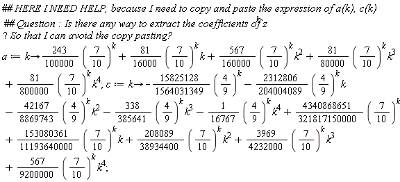

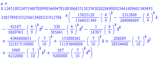

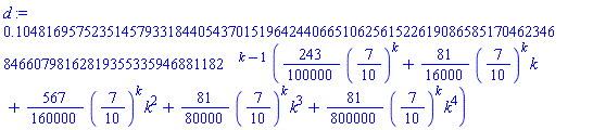

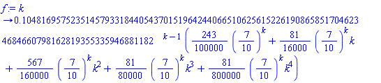

Dear experts,
 I want to extract the coefficient of z^k from an infinite series summation (known as probability generating function or characteristic function or Z-transformation) , the co-efficient is actually the probability of the R.V. will take value k.
Next problem in the same question is the summation is not working if I sum from 0 to infinity. It is working from 0 to 300.
I have attached the PDF for expressing the problem and the Maple code. I have used convert(.., FormalPowerSeries,.. );
Question_FPS.pdfQuestion_FPS.pdfQuest_FormalPowerSer.mw

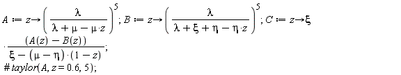

A := proc (z) options operator, arrow; lambda^5/(lambda+mu-mu*z)^5 end proc;
proc (z) options operator, arrow; lambda^5/(lambda+xi+eta-eta*z)^5 end proc
proc (z) options operator, arrow; xi*(A(z)-B(z))/(xi-(mu-eta)*(1-z)) end proc

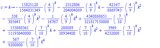

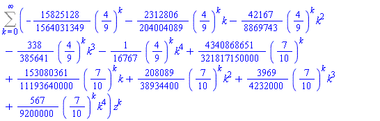

convert(C(z), FormalPowerSeries, z);
Sum((-(15825128/1564031349)*(4/9)^k-(2312806/204004089)*(4/9)^k*k-(42167/8869743)*(4/9)^k*k^2-(338/385641)*(4/9)^k*k^3-(1/16767)*(4/9)^k*k^4+(4340868651/321817150000)*(7/10)^k+(153080361/11193640000)*(7/10)^k*k+(208089/38934400)*(7/10)^k*k^2+(3969/4232000)*(7/10)^k*k^3+(567/9200000)*(7/10)^k*k^4)*z^k, k = 0 .. infinity)
a := proc (k) options operator, arrow; (243/100000)*(7/10)^k+(81/16000)*(7/10)^k*k+(567/160000)*(7/10)^k*k^2+(81/80000)*(7/10)^k*k^3+(81/800000)*(7/10)^k*k^4 end proc; c := proc (k) options operator, arrow; -(15825128/1564031349)*(4/9)^k-(2312806/204004089)*(4/9)^k*k-(42167/8869743)*(4/9)^k*k^2-(338/385641)*(4/9)^k*k^3-(1/16767)*(4/9)^k*k^4+(4340868651/321817150000)*(7/10)^k+(153080361/11193640000)*(7/10)^k*k+(208089/38934400)*(7/10)^k*k^2+(3969/4232000)*(7/10)^k*k^3+(567/9200000)*(7/10)^k*k^4 end proc

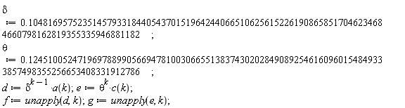

delta := .1048169575235145793318440543701519642440665106256152261908658517046234684660798162819355335946881182;
.1245100524719697889905669478100306655138374302028490892546160960154849333857498355256653408331912786
.1048169575235145793318440543701519642440665106256152261908658517046234684660798162819355335946881182^(k-1)*((243/100000)*(7/10)^k+(81/16000)*(7/10)^k*k+(567/160000)*(7/10)^k*k^2+(81/80000)*(7/10)^k*k^3+(81/800000)*(7/10)^k*k^4)
.1245100524719697889905669478100306655138374302028490892546160960154849333857498355256653408331912786^k*(-(15825128/1564031349)*(4/9)^k-(2312806/204004089)*(4/9)^k*k-(42167/8869743)*(4/9)^k*k^2-(338/385641)*(4/9)^k*k^3-(1/16767)*(4/9)^k*k^4+(4340868651/321817150000)*(7/10)^k+(153080361/11193640000)*(7/10)^k*k+(208089/38934400)*(7/10)^k*k^2+(3969/4232000)*(7/10)^k*k^3+(567/9200000)*(7/10)^k*k^4)
proc (k) options operator, arrow; .1048169575235145793318440543701519642440665106256152261908658517046234684660798162819355335946881182^(k-1)*((243/100000)*(7/10)^k+(81/16000)*(7/10)^k*k+(567/160000)*(7/10)^k*k^2+(81/80000)*(7/10)^k*k^3+(81/800000)*(7/10)^k*k^4) end proc

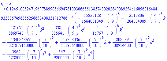

proc (k) options operator, arrow; .1245100524719697889905669478100306655138374302028490892546160960154849333857498355256653408331912786^k*(-(15825128/1564031349)*(4/9)^k-(2312806/204004089)*(4/9)^k*k-(42167/8869743)*(4/9)^k*k^2-(338/385641)*(4/9)^k*k^3-(1/16767)*(4/9)^k*k^4+(4340868651/321817150000)*(7/10)^k+(153080361/11193640000)*(7/10)^k*k+(208089/38934400)*(7/10)^k*k^2+(3969/4232000)*(7/10)^k*k^3+(567/9200000)*(7/10)^k*k^4) end proc

sum(theta^k*c(k), k = 1 .. 200); sum(g(k), k = 1 .. 200); sum(g(k), k = 1 .. 300)
0.1854156167422363765076984332241875155540949949705316457513708419061619470578009411403103805950641336e-2
