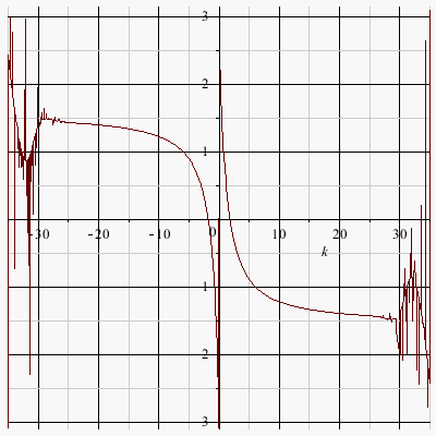

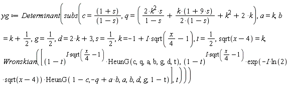

I have added a .mw file showing the problem. I wish to calculate the integral at the bottom of the post. unfortunately the function im using defined at he beginning of the file doesnt behave well for values k larger than 25/30...
The integral I need to evaluate therefore cant be evaluated if one wants to integrate from 0 to Infinity.
Also just integrating till 20 or so is not accurate enough...
Has anybody an idea about better implementation of the problem.mapleprimes.mw
yg := Determinant(subs(c = (1+s)/(1-s), q = 2*k^2*s/(1-s)+k*(1+9*s)/(2*(1-s))+k^2+2*k, a = k, b = k+1/2, g = 1/2, d = 2*k+3, s = 1/2, k = -1+I*sqrt((1/4)*x-1), t = 1/2, sqrt(x-4) = k, Wronskian([(1-t)^(I*sqrt((1/4)*x-1))*HeunG(c, q, a, b, g, d, t), (1-t)^(I*sqrt((1/4)*x-1))*exp(-I*ln(2)*sqrt(x-4))*HeunG(1-c, -q+a*b, a, b, d, g, 1-t)], t)))

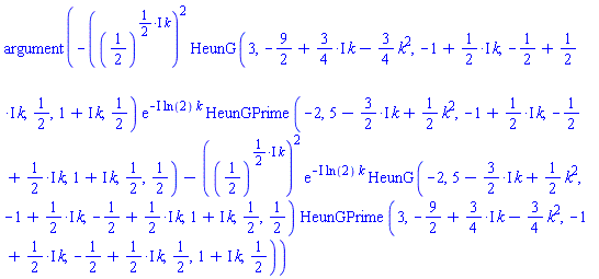

deltag := argument(yg)
argument(-((1/2)^(((1/2)*I)*k))^2*HeunG(3, -9/2+((3/4)*I)*k-(3/4)*k^2, -1+((1/2)*I)*k, -1/2+((1/2)*I)*k, 1/2, 1+I*k, 1/2)*exp(-I*ln(2)*k)*HeunGPrime(-2, 5-((3/2)*I)*k+(1/2)*k^2, -1+((1/2)*I)*k, -1/2+((1/2)*I)*k, 1+I*k, 1/2, 1/2)-((1/2)^(((1/2)*I)*k))^2*exp(-I*ln(2)*k)*HeunG(-2, 5-((3/2)*I)*k+(1/2)*k^2, -1+((1/2)*I)*k, -1/2+((1/2)*I)*k, 1+I*k, 1/2, 1/2)*HeunGPrime(3, -9/2+((3/4)*I)*k-(3/4)*k^2, -1+((1/2)*I)*k, -1/2+((1/2)*I)*k, 1/2, 1+I*k, 1/2))
plot(deltag, k = -35 .. 35)

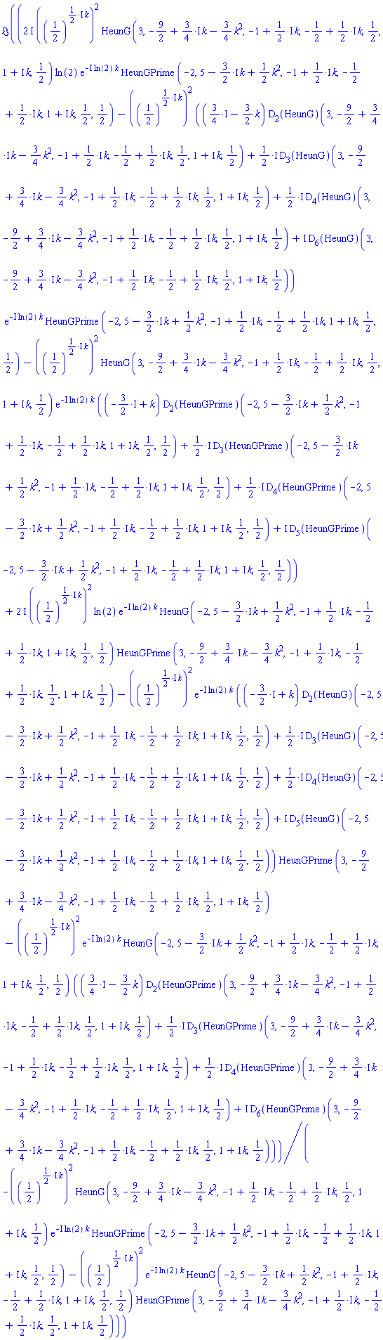

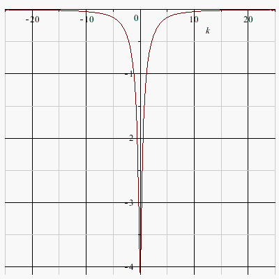

diffdeltag := Im(diff(ln(yg), k))
Im(((2*I)*((1/2)^(((1/2)*I)*k))^2*HeunG(3, -9/2+((3/4)*I)*k-(3/4)*k^2, -1+((1/2)*I)*k, -1/2+((1/2)*I)*k, 1/2, 1+I*k, 1/2)*ln(2)*exp(-I*ln(2)*k)*HeunGPrime(-2, 5-((3/2)*I)*k+(1/2)*k^2, -1+((1/2)*I)*k, -1/2+((1/2)*I)*k, 1+I*k, 1/2, 1/2)-((1/2)^(((1/2)*I)*k))^2*(((3/4)*I-(3/2)*k)*(D[2](HeunG))(3, -9/2+((3/4)*I)*k-(3/4)*k^2, -1+((1/2)*I)*k, -1/2+((1/2)*I)*k, 1/2, 1+I*k, 1/2)+((1/2)*I)*(D[3](HeunG))(3, -9/2+((3/4)*I)*k-(3/4)*k^2, -1+((1/2)*I)*k, -1/2+((1/2)*I)*k, 1/2, 1+I*k, 1/2)+((1/2)*I)*(D[4](HeunG))(3, -9/2+((3/4)*I)*k-(3/4)*k^2, -1+((1/2)*I)*k, -1/2+((1/2)*I)*k, 1/2, 1+I*k, 1/2)+I*(D[6](HeunG))(3, -9/2+((3/4)*I)*k-(3/4)*k^2, -1+((1/2)*I)*k, -1/2+((1/2)*I)*k, 1/2, 1+I*k, 1/2))*exp(-I*ln(2)*k)*HeunGPrime(-2, 5-((3/2)*I)*k+(1/2)*k^2, -1+((1/2)*I)*k, -1/2+((1/2)*I)*k, 1+I*k, 1/2, 1/2)-((1/2)^(((1/2)*I)*k))^2*HeunG(3, -9/2+((3/4)*I)*k-(3/4)*k^2, -1+((1/2)*I)*k, -1/2+((1/2)*I)*k, 1/2, 1+I*k, 1/2)*exp(-I*ln(2)*k)*((-(3/2)*I+k)*(D[2](HeunGPrime))(-2, 5-((3/2)*I)*k+(1/2)*k^2, -1+((1/2)*I)*k, -1/2+((1/2)*I)*k, 1+I*k, 1/2, 1/2)+((1/2)*I)*(D[3](HeunGPrime))(-2, 5-((3/2)*I)*k+(1/2)*k^2, -1+((1/2)*I)*k, -1/2+((1/2)*I)*k, 1+I*k, 1/2, 1/2)+((1/2)*I)*(D[4](HeunGPrime))(-2, 5-((3/2)*I)*k+(1/2)*k^2, -1+((1/2)*I)*k, -1/2+((1/2)*I)*k, 1+I*k, 1/2, 1/2)+I*(D[5](HeunGPrime))(-2, 5-((3/2)*I)*k+(1/2)*k^2, -1+((1/2)*I)*k, -1/2+((1/2)*I)*k, 1+I*k, 1/2, 1/2))+(2*I)*((1/2)^(((1/2)*I)*k))^2*ln(2)*exp(-I*ln(2)*k)*HeunG(-2, 5-((3/2)*I)*k+(1/2)*k^2, -1+((1/2)*I)*k, -1/2+((1/2)*I)*k, 1+I*k, 1/2, 1/2)*HeunGPrime(3, -9/2+((3/4)*I)*k-(3/4)*k^2, -1+((1/2)*I)*k, -1/2+((1/2)*I)*k, 1/2, 1+I*k, 1/2)-((1/2)^(((1/2)*I)*k))^2*exp(-I*ln(2)*k)*((-(3/2)*I+k)*(D[2](HeunG))(-2, 5-((3/2)*I)*k+(1/2)*k^2, -1+((1/2)*I)*k, -1/2+((1/2)*I)*k, 1+I*k, 1/2, 1/2)+((1/2)*I)*(D[3](HeunG))(-2, 5-((3/2)*I)*k+(1/2)*k^2, -1+((1/2)*I)*k, -1/2+((1/2)*I)*k, 1+I*k, 1/2, 1/2)+((1/2)*I)*(D[4](HeunG))(-2, 5-((3/2)*I)*k+(1/2)*k^2, -1+((1/2)*I)*k, -1/2+((1/2)*I)*k, 1+I*k, 1/2, 1/2)+I*(D[5](HeunG))(-2, 5-((3/2)*I)*k+(1/2)*k^2, -1+((1/2)*I)*k, -1/2+((1/2)*I)*k, 1+I*k, 1/2, 1/2))*HeunGPrime(3, -9/2+((3/4)*I)*k-(3/4)*k^2, -1+((1/2)*I)*k, -1/2+((1/2)*I)*k, 1/2, 1+I*k, 1/2)-((1/2)^(((1/2)*I)*k))^2*exp(-I*ln(2)*k)*HeunG(-2, 5-((3/2)*I)*k+(1/2)*k^2, -1+((1/2)*I)*k, -1/2+((1/2)*I)*k, 1+I*k, 1/2, 1/2)*(((3/4)*I-(3/2)*k)*(D[2](HeunGPrime))(3, -9/2+((3/4)*I)*k-(3/4)*k^2, -1+((1/2)*I)*k, -1/2+((1/2)*I)*k, 1/2, 1+I*k, 1/2)+((1/2)*I)*(D[3](HeunGPrime))(3, -9/2+((3/4)*I)*k-(3/4)*k^2, -1+((1/2)*I)*k, -1/2+((1/2)*I)*k, 1/2, 1+I*k, 1/2)+((1/2)*I)*(D[4](HeunGPrime))(3, -9/2+((3/4)*I)*k-(3/4)*k^2, -1+((1/2)*I)*k, -1/2+((1/2)*I)*k, 1/2, 1+I*k, 1/2)+I*(D[6](HeunGPrime))(3, -9/2+((3/4)*I)*k-(3/4)*k^2, -1+((1/2)*I)*k, -1/2+((1/2)*I)*k, 1/2, 1+I*k, 1/2)))/(-((1/2)^(((1/2)*I)*k))^2*HeunG(3, -9/2+((3/4)*I)*k-(3/4)*k^2, -1+((1/2)*I)*k, -1/2+((1/2)*I)*k, 1/2, 1+I*k, 1/2)*exp(-I*ln(2)*k)*HeunGPrime(-2, 5-((3/2)*I)*k+(1/2)*k^2, -1+((1/2)*I)*k, -1/2+((1/2)*I)*k, 1+I*k, 1/2, 1/2)-((1/2)^(((1/2)*I)*k))^2*exp(-I*ln(2)*k)*HeunG(-2, 5-((3/2)*I)*k+(1/2)*k^2, -1+((1/2)*I)*k, -1/2+((1/2)*I)*k, 1+I*k, 1/2, 1/2)*HeunGPrime(3, -9/2+((3/4)*I)*k-(3/4)*k^2, -1+((1/2)*I)*k, -1/2+((1/2)*I)*k, 1/2, 1+I*k, 1/2)))
plot(diffdeltag, k = -25 .. 25)
