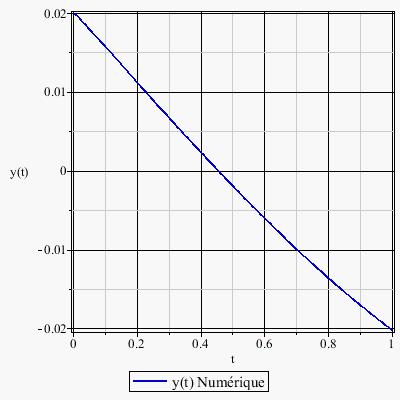

plots:-odeplot(sol, [t, y(t)], t = 0 .. 1, labels = ["t", "y(t)"], color = blue, thickness = 1, legend = ["y(t) Numérique"], axes = boxed);

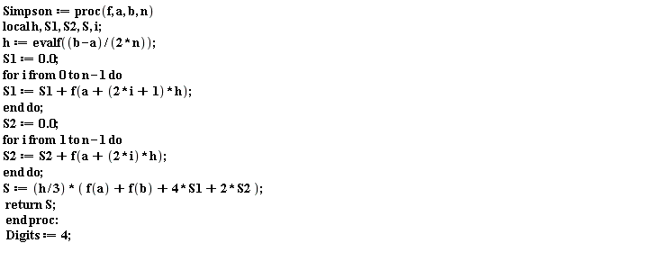

Simpson := proc (f, a, b, n) local h, S1, S2, S, i; h := evalf((1/2)*(b-a)/n); S1 := 0.; for i from 0 to n-1 do S1 := S1+f(a+(2*i+1)*h) end do; S2 := 0.; for i to n-1 do S2 := S2+f(a+2*i*h) end do; S := (1/3)*h*(f(a)+f(b)+4*S1+2*S2); return S end proc:

Hi evey ones ;
how can i convert these code below TO matlab
thank a lot Maple_to_MATLAB.mw
