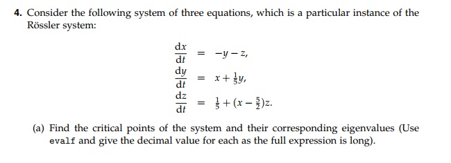

I was asked to solve this problem:
and ending up with this:
Qmaple.mw
In Solut,if I replace evalf by solve I get a sensible solution.However,it is explicitly written in the question that I should use evalf to get an exact answer.How should I modify my code?
