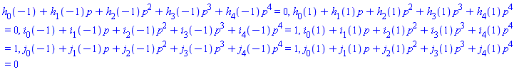

cond[1][0] := f[0](-1) = -1, (D(f[0]))(-1) = 0, f[0](1) = 1, (D(f[0]))(1) = 0; g[0](-1) = 0, g[0](1) = 0, a[0](-1) = 1, a[0](1) = 1, b[0](-1) = 1, b[0](1) = 0
Error, (in anonymous procedure) invalid input: diff received -1, which is not valid for its 2nd argument
h[0](-1)+h[1](-1)*p+h[2](-1)*p^2+h[3](-1)*p^3+h[4](-1)*p^4 = 0, h[0](1)+h[1](1)*p+h[2](1)*p^2+h[3](1)*p^3+h[4](1)*p^4 = 0, i[0](-1)+i[1](-1)*p+i[2](-1)*p^2+i[3](-1)*p^3+i[4](-1)*p^4 = 1, i[0](1)+i[1](1)*p+i[2](1)*p^2+i[3](1)*p^3+i[4](1)*p^4 = 1, j[0](-1)+j[1](-1)*p+j[2](-1)*p^2+j[3](-1)*p^3+j[4](-1)*p^4 = 1, j[0](1)+j[1](1)*p+j[2](1)*p^2+j[3](1)*p^3+j[4](1)*p^4 = 0
