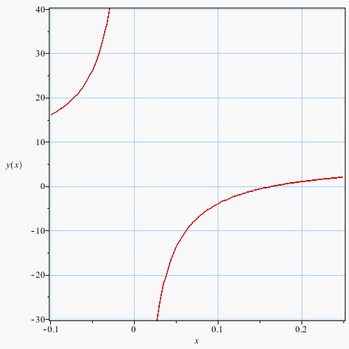

sometimes when using DEtools:-DEplot, it gives warning on singularity in solution and only plots part of the solution (on top of the slope field) on one side of the singularity.  But the plot() command works and there is no such warning, and it plots the solution on both sides of the singularity on its own.
Is there a way to make DEtools:-DEplot do the same? In this case the solution is y(x) = -1/x + 6 and x=0 is singularity. Here is worksheet showing such an example
It seems DEtools:-DEplot does not use same internal plotting code that plot used to superimpose the solution plot on top of the slope field plot?
ode:=diff(y(x),x) = 1/x^2;
IC:=y(1) = 5;
sol:=dsolve([ode,IC]);
p:=plot(rhs(sol),'axes'='boxed','labels'=[x,y(x)],'axis'=['gridlines'=['color'='lightblue']],'color' = 'red');
diff(y(x), x) = 1/x^2
y(1) = 5
y(x) = -1/x+6
T:=rhs~(indets(p, identical("originalview")=anything))[];
from_x := op(1,T[1]);
to_x   := op(2,T[1]);
from_y := op(1,T[2]);
to_y   := op(2,T[2]);
[-.1000000000 .. .2500000000, -30. .. 40.]
-.1000000000
.2500000000
-30.
40.

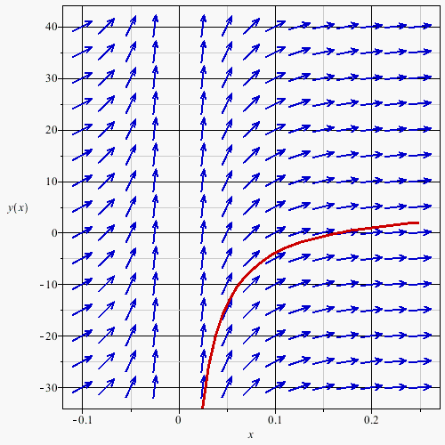

DEtools:-DEplot(ode,[y(x)],x=from_x..to_x,y=from_y ..to_y ,[IC],
                'dirfield'=[15,15],
                'labels'=[x,y(x)],
                'axes' = 'boxed',
                'arrows'='smalltwo', #'curve',
                'color' = 'blue',#color of arrows
                'linecolor'='red',#color of solution
                'obsrange'=false
Warning, plot may be incomplete, the following errors(s) were issued:
   cannot evaluate the solution further left of .73124308e-99, probably a singularity

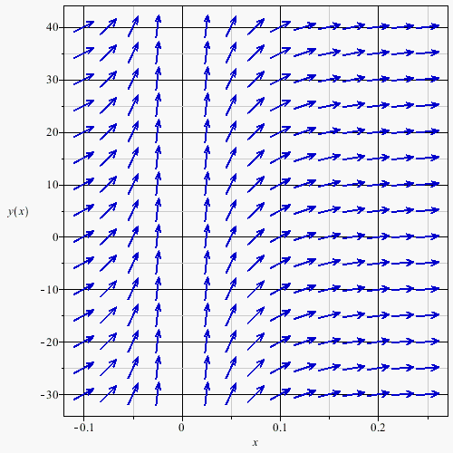

One possibility I can do is to plot slope field without passing it initial conditions. THis makes it not plot the solution and only show the slope field. Then use display to superimpse the solution plot from plot() comamnd. And this now works, like this:
ode:=diff(y(x),x) = 1/x^2:
IC:=y(1) = 5:
sol:=dsolve([ode,IC]):
p1:=plot(rhs(sol),'axes'='boxed','labels'=[x,y(x)],'axis'=['gridlines'=['color'='lightblue']],'color' = 'red'):
from_x := op(1,T[1]):
to_x   := op(2,T[1]):
from_y := op(1,T[2]):
to_y   := op(2,T[2]):

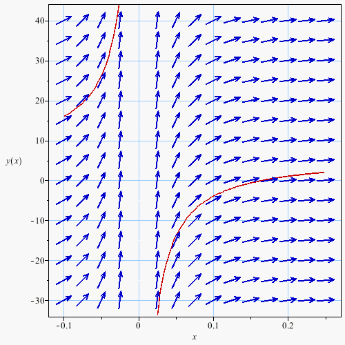

p2:=DEtools:-DEplot(ode,[y(x)],x=from_x..to_x,y=from_y ..to_y ,
                'dirfield'=[15,15],
                'labels'=[x,y(x)],
                'axes' = 'boxed',
                'obsrange'=false
plots:-display([p1,p2])
Download handling_signularity_in_slope_field_V1.mw
But before I change my code to do this, I thought to ask in case there is an option in DEtools:-DEplot which makes it handle the solution plot as is like plot() did. If not, then I can use display.

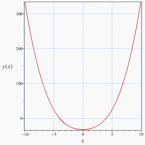

I use plot(sol,...) to plot solution of ode. I do not give x or y ranges and let Maple figure the best values. Then use the command
To extract the x and y ranges used and then use these in the command DEtools:-DEplot(....)
The plot() command shows the solution plot fully (in this example below, the left and right sides).
But the  DEtools:-DEplot(....) only shows part of the solution on top of the slope field arrows.  Even though the same x and y ranges is used.
I found that if I increase the y range for the DEtools:-DEplot(....) by a little bit, now the full solution shows, which is same as plot command generated.
Since I am doing all this in code, without looking, I am first plotting the solution using plot() and then use the ranges generated for DEtools:-DEplot(....).
If I do not use the y range in DEtools:-DEplot(....) but only use the x range, sometimes it works and sometimes Maple gives warnings. (depending on the solution). So I am  back to using the ranges generated by plot() command to be safe.
Here is an example to show this problem
ode:=diff(y(x),x) = x*(x^2+9)^(1/2);
IC:=y(-4) = 0;
Now the x and y ranges used above is extraced
to_x   := op(2,T[1]);
to_y   := op(2,T[2]);
#gives
      T := [-9.94999999999999929 .. 9.94999999999999929,
        -32.6629164062620561 .. 332.469298224442980]
                 from_x := -9.94999999999999929
                  to_x := 9.94999999999999929
                 from_y := -32.6629164062620561
                  to_y := 332.469298224442980

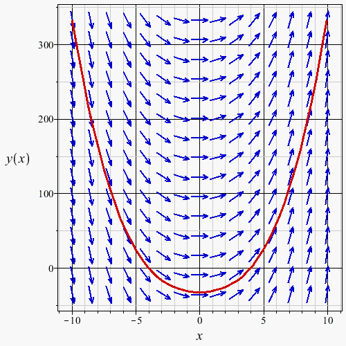

These are used in the DEplot
                'dirfield'=[15,15],
                'labels'=[x,y(x)],
                'axes' = 'boxed',
                'linecolor'='red'#color of solution
Notice how the solution (red line) is truncated.  It turns out in this case adding say 10% to the y range, it now shows the solution like this
DEtools:-DEplot(ode,[y(x)],x=from_x..to_x,y=from_y-(0.1*abs(from_y)) ..to_y ,[IC],
                'dirfield'=[15,15],
                'labels'=[x,y(x)],
                'axes' = 'boxed',
But I do not know if this trick will work for each example.
As I said, I can not give the y range to DEplot, then in this example, it will now show the full solution. But I have examples where this can cause warnings.
The question is, why giving same y range used by plot to DEplot cause the solution (red line) to truncate? Why one has to increase the y range to make it show the full solution?
Is there a better method that the above to make DEplot show full solution same as plot() does?
