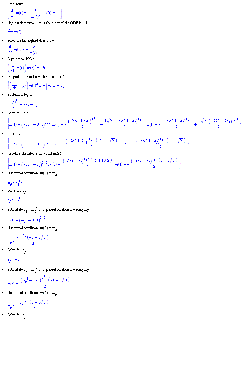

Any one could find why dsolve can't solve this first order ode when adding IC,  but Student:-ODEs:-ODESteps can?
Physics:-Version();
`The "Physics Updates" version in the MapleCloud is 1878 and is the same as the version installed in this computer, created 2025, September 28, 11:35 hours Pacific Time.`
SupportTools:-Version();
ode:=diff(m(t),t) = -k/m(t)^2;
ic:=m(0) = m__0;
DEtools:-odeadvisor(ode);
diff(m(t), t) = -k/m(t)^2
m(0) = m__0
[_quadrature]
sol:=dsolve(ode)
m(t) = (-3*k*t+c__1)^(1/3), m(t) = -(1/2)*(-3*k*t+c__1)^(1/3)-((1/2)*I)*3^(1/2)*(-3*k*t+c__1)^(1/3), m(t) = -(1/2)*(-3*k*t+c__1)^(1/3)+((1/2)*I)*3^(1/2)*(-3*k*t+c__1)^(1/3)
sol:=dsolve([ode,ic])
Student:-ODEs:-ODESteps([ode,ic])
"[[,,"Let's solve"],[,,[(ⅆ)/(ⅆt) m(t)=-k/((m(t))^2),m(0)=`m__0`]],["•",,"Highest derivative means the order of the ODE is" 1],[,,(ⅆ)/(ⅆt) m(t)],["•",,"Solve for the highest derivative"],[,,(ⅆ)/(ⅆt) m(t)=-k/((m(t))^2)],["•",,"Separate variables"],[,,((ⅆ)/(ⅆt) m(t)) (m(t))^2=-k],["•",,"Integrate both sides with respect to" t],[,,∫((ⅆ)/(ⅆt) m(t)) (m(t))^2 ⅆt=∫-k ⅆt+`c__1`],["•",,"Evaluate integral"],[,,((m(t))^3)/3=-k t+`c__1`],["•",,"Solve for" m(t)],[,,{m(t)=(-3 k t+3 `c__1`)^(1/3),m(t)=-((-3 k t+3 `c__1`)^(1/3))/2-(ⅈ sqrt(3) (-3 k t+3 `c__1`)^(1/3))/2,m(t)=-((-3 k t+3 `c__1`)^(1/3))/2+(ⅈ sqrt(3) (-3 k t+3 `c__1`)^(1/3))/2}],["•",,"Simplify"],[,,{m(t)=(-3 k t+3 `c__1`)^(1/3),m(t)=((-3 k t+3 `c__1`)^(1/3) (-1+ⅈ sqrt(3)))/2,m(t)=-((-3 k t+3 `c__1`)^(1/3) (1+ⅈ sqrt(3)))/2}],["•",,"Redefine the integration constant(s)"],[,,{m(t)=(-3 k t+`c__1`)^(1/3),m(t)=((-3 k t+`c__1`)^(1/3) (-1+ⅈ sqrt(3)))/2,m(t)=-((-3 k t+`c__1`)^(1/3) (1+ⅈ sqrt(3)))/2}],["•",,"Use initial condition" m(0)=`m__0`],[,,`m__0`=`c__1`^(1/3)],["•",,"Solve for" `c__1`],[,,`c__1`=`m__0`^3],["•",,"Substitute" `c__1`=`m__0`^3 "into general solution and simplify"],[,,m(t)=(`m__0`^3-3 k t)^(1/3)],["•",,"Use initial condition" m(0)=`m__0`],[,,`m__0`=(`c__1`^(1/3) (-1+ⅈ sqrt(3)))/2],["•",,"Solve for" `c__1`],[,,`c__1`=`m__0`^3],["•",,"Substitute" `c__1`=`m__0`^3 "into general solution and simplify"],[,,m(t)=((`m__0`^3-3 k t)^(1/3) (-1+ⅈ sqrt(3)))/2],["•",,"Use initial condition" m(0)=`m__0`],[,,`m__0`=-(`c__1`^(1/3) (1+ⅈ sqrt(3)))/2],["•",,"Solve for" `c__1`],[,,`c__1`=`m__0`^3],["•",,"Substitute" `c__1`=`m__0`^3 "into general solution and simplify"],[,,m(t)=-((`m__0`^3-3 k t)^(1/3) (1+ⅈ sqrt(3)))/2],["•",,"Solutions to the IVP"],[,,[m(t)=(`m__0`^3-3 k t)^(1/3),m(t)=((`m__0`^3-3 k t)^(1/3) (-1+ⅈ sqrt(3)))/2,m(t)=-((`m__0`^3-3 k t)^(1/3) (1+ⅈ sqrt(3)))/2]]]"
Download why_dsolve_cant_solve_ode_oct_4_2025_maple_2025_1.mw
Given an ode with IC. When solution is explicit, Maple resolves the constant of integration as expected and returns solution with no c__1 in it.
But when asked for implicit solution, also with same IC, it now returns solution with c__1 still there.
Is this by design or a bug? Should not constant of integration be resolved using IC in both cases? If unable to solve for c__1 because solution is implicit, should it then not return solution all?
Does this happen in earlier versions of Maple?
